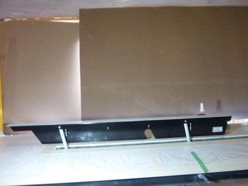

Brief Description:  Assembled and locktited right airbrake assembly

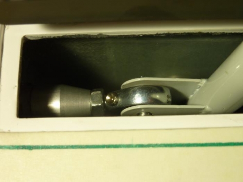

Assemble airbrake cover to airbrake with springs, locktited screws and tighted them. Applied red marking paint. Drilled holes and riveted the cover stablizer brackets on the airbrake. Temporarily assemble brake and then used tool to measure torque to close. Adjusted pushrod bearing end out until torque reading was at least 80 Kg-cm, Applied blue locktite to the pushrod bearing screw and lock nut and locked it in place. Put blue locktite on airbrake mounting screws and tighted them down. Applied red marking paint to all nuts. Right and Left airbrakes are now both complete.
