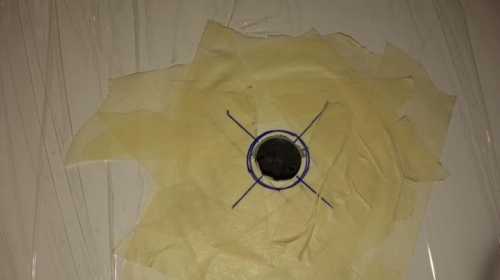

Brief Description:  Grinding hole in top of wing for fuel cap
Started grinding hole in left wing for fuel cap. Factory marked location to drill the initial hole. Tank has a plastic plug in the opening to keep dust out. Slow process grinding away carbon fiber and epoxy without slipping and maring wing and trying not go grind the aluminum tank filler neck. Only 2-3mm of epoxy/carbon fiber on top of filler neck that needs to be removed to allow rim of cap to seat in wing.
