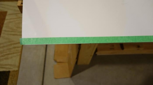

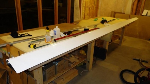

Brief Description:  Trimmed trailing edge of right aileron
Had to trim off the area were the two haves of the aileron were clamped together in the manufacturing process. It was hard to determine how much to take off, so I just sort of eyeballed it applying masking tape right along the “curve” in the tail of the aileron where the clamps were applied to hold the skin on the aileron while the epoxy dried. I then used my power belt sander to sand just up to the edge of the tape.
