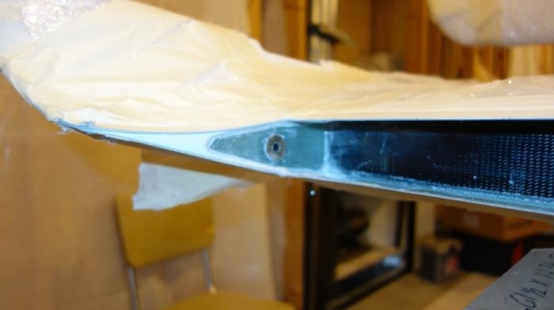

Date:  1-31-2016
Brief Description:  Finished fitting and installed flapperon for left
I have sanded the trailing edge of the left wing so the flapperon has at least a 1/16 inch clearance. Finished grinding the the hing holes so the flapperon deflects 33 degrees down and 28 degrees up. Cleaned the hinge pins, greased them up and assemble the flapperon. Did not locktite the hinge pin bolt yet because I will have to remove it to get wing out of the basement.
