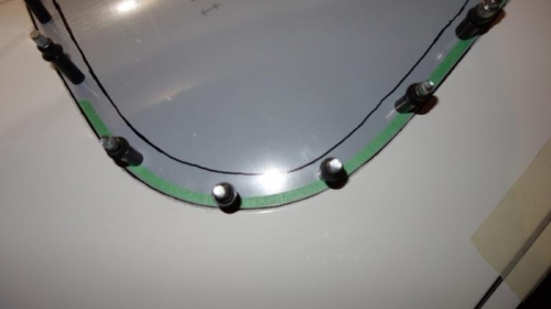

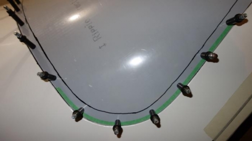

Date:  11-4-2015
Brief Description:  Marked windshield for sanding and painting
Fixed one of the windshield rivet holes at the top were the rivet channel cover was filled with epoxy. Used a dremel tool and a small bit to make an inverted cone shaped hole so the rivet will grab and hold.
