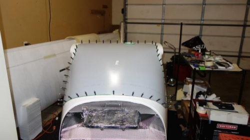

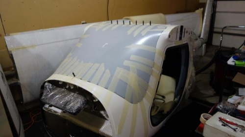

Date:  11-1-2015
Number of Hours:  4.00
Brief Description:  Attached windshield to fuselage and drilled rivet
Used tape to attach and align windshield to fuselage. Then use 4mm drill (with 10mm drill stop) and drilled holes in fuselage using pre-drilled holes in windshield as a guide. Inserted cleco after drilling each hole. Everything went well except for bottom right. Had a very slight bubble that I could not work out. I should have stopped drilling and re-tensioned the windshield by re-taping. There should be enough play when I over drill the windshield rivet holes to work this bubble out.
