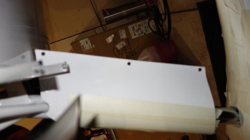

Installed airfoil on nose gear strut
Velcro was already installed on the airfoil. Attached mounting bracket on the back of nose wheel. Drilled holes in airfoil with center screw through the mounting bracket. Loctited screws.
