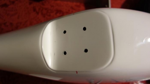

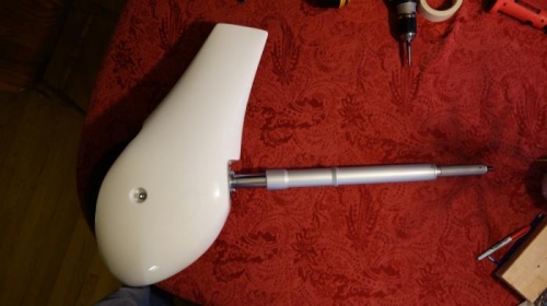

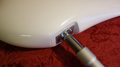

Brief Description:  Installed nose wheel and wheel fairing on strut
Measured and drilled holes in nose wheel faring. used a square and blocks of wood to align faring to nose wheel bracket, installed. Tight tolerance from were the top faring bracket ends and the faring starts to curve upward and still keeping the bracket nose wheel bolt inside the bolt recess. It took lots of patience measuring. Drilled one hole, verified location and angle, then use d bolt and nut to lock the bracket into the faring and drilled the remaining 3 holes, installed a 2nd bolt and nut and drilled the wheel bolt holes in the faring recesses
