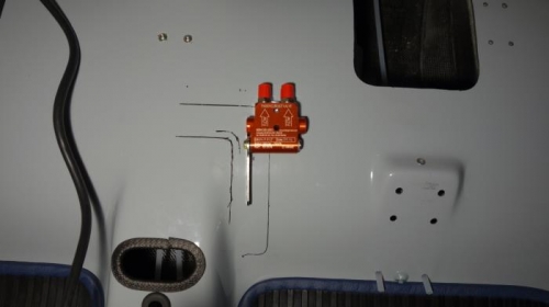

Date:  8-9-2015
Number of Hours:  5.00
Brief Description:  Installed parking brake and cut remaining brake li
I choose to move the parking brake forward from recommended location to alongside the instrument panel. I had to cut a slot in both the floor and the instrument panel floor mount for the actuation lever. Cut remaining brake line holes in cockpit floor and mounted (temporarily until I install landing gear) the parking brake. Came up with a method to secure the brake lines on the bottom of the fuselage floor so they won't interfere with the flight controls
