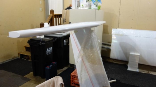

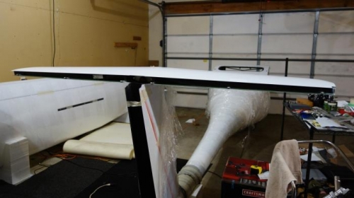

Brief Description:  Fitted and mounted the horizontal stab

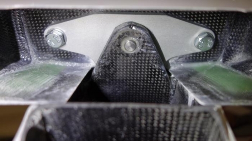

Put attachment bolt and locking harware in the stab, sanded/ground the rear plate on the vertical stablizer so the it would not hit the horizontal stab and also so it would mount the elevator control horn. Test fit the stab. Had to clean up excess epoxy on the mounting holes (used a file), The mounting bolt was not perfectly vertical so it bound the locking mechanism so that it would not slide up and lock the bolt. I had to grind the locking mechanism so it would slide up and down again.
