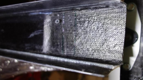

Date:  7-18-2015
Number of Hours:  2.50
Brief Description:  Installed tubing to hold wire for rear rudder moun
Purchased some nylon brakeline tubing and ran if from the rear vertical stablizer to the cabin. This was a challenge because of the small rear fuselage size. Used an 36" long 1/4" drill to drill holes in the rib between the vertical stab and the fuselage and also in the rear fuselage bulk head. Used various wires the 36" long drill to fish the tubing through the vertical stab and rear bulkhead. I was able to get my hand in the elevator control rod access hole to get the tubing to make the corner from the fuselage to the vertical stab. Made a hook from heavy (#10 gauge copper wire) to hook nylon tubing in tail after feeding it through rear fuselage bulkhead up to a hole I drilled just below the top rudder hing pin mount
