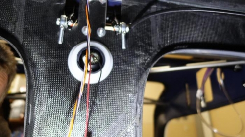

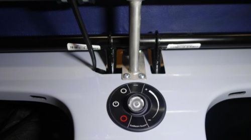

Installed Cockpit light
Installed seats to check for clearances Marked location and drilled 44mm hole with hole saw. The hole was a little small (needed 45mm). Used dremel to enlarge and make slot for wire. Installed light.
