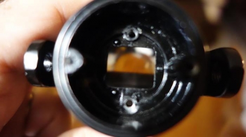

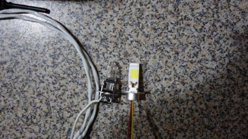

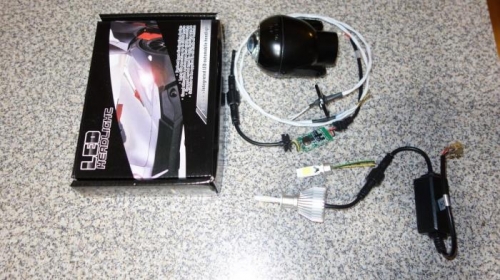

Brief Description:  Swapped out incandescent landing light bulb
Found a 3,000 lumen 30W H3 mount LED Headlight for $13 on line so I swapped it for the higher current yet dimmer 55W incandescent light that came with the landing light in the kit. I had to cut off the heat sink (the light housing is metal and should dissipate the heat from the LED just fine. Automobiles usually use a plastic headlight). The light comes with a current limiter which I dis-assembled and will connect aircraft grade wiring to.
