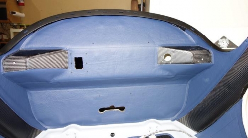

Date:  8-30-2015
Brief Description:  Cut holes in firewall upholstery and firewall heat
Use a sharp utility knife to cut through the firewall heat shield before attaching upholstery, then attached the inner firewall upholstery and used a red hot screw driver to make small round holes it the leather and insulation. I then used a red hot screw driver to melt the insulation behind the two large holes (nose wheel steering and cable pass-thru). Used a sharp exacto knife to cut through the leather.
