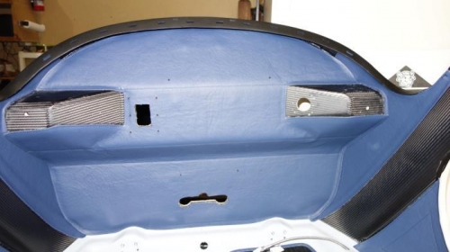

Brief Description:  Applied the insulated firewall upholstery to the c
Again used tape to align and applied contact cement and attached firewall upholstery. I worked from the top down using the tape to align, then then pressed it on. I then worked the leather around the bump protruding from the firewall pressing it on while holding the bottom away from the firewall so I would accidentally touch (and stick). I should have paid more attention to the leather as I was applying and I would have noticed it was running a little to the right. I could have worked to to the left. It still looks ok (just a little more overlap on the right than on the left) but It is not "perfect".
