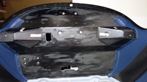

Brief Description:  Installed the forward side upholstery
Cut and fit the upholstery on the forward sides of the cockpit, taped it in place using masking tape, then cut the tape around the edges of the upholstery so it would remain as a position mark after I applied the contact cement. Again this worked very well and I was able to accurately apply the upholstery on the first try.
