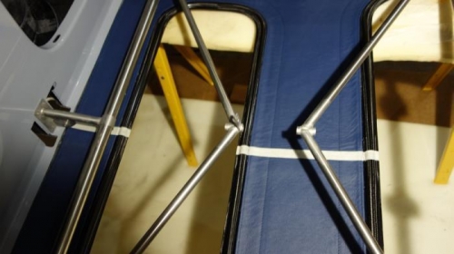

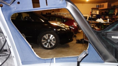

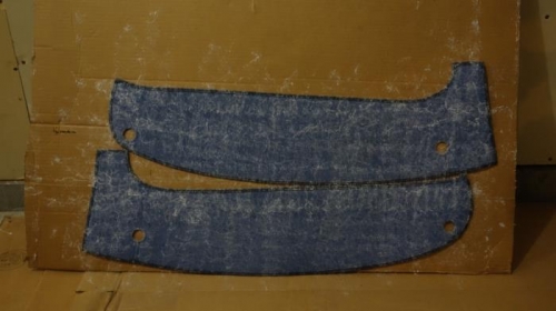

Fitted the interior upholstery. After I got the upholstery positioned correctly, I put a strip of masking tape to mark the center. Then I applied paint on contact cement to the fuselage and spray on contact cement to the leather upholstery. Once dried, I used the tape to line up the center, pressed it down to fix it in place, then pressed down moving to the sides lining it up and pressing it into place. The tape worked great to get it lined up before the contact cement grabs it (you only get one chance to get it positioned correctly. Then I cut out the holes for the wing spars, fuel gauge, speed brake and aileron locations.
