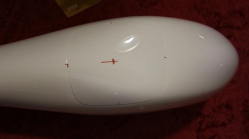

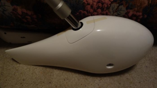

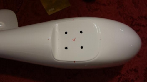

Brief Description:  Installed the nose wheel faring strut cover
Marked the faring to get the center of the strut location, transferred that location to the strut cover, Used a 1 1/2" hole saw to drill a hole in the cover for the strut (didn't have a 1 5/8" hole saw and hole saws are not that accurate). Used a Dremel tool to grind the hole to the size of the strut, then slid the cover over the strut.
