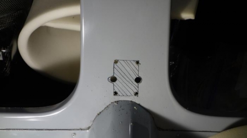

Brief Description:  Cut hole for flap control bar. Layed out and teste
Tested electric trim controller to see if multiple inputs (i.e. if I have 2 or more trims control switches) are handled correctly. If both up and down trim are switched on at the same time, the trim will move in the up direction. This is good news, I am planning on mounting trim switches on each control stick (and leaving the center switch active and now I have determined that I don't have to have a switch to select which trim switch is in control.
