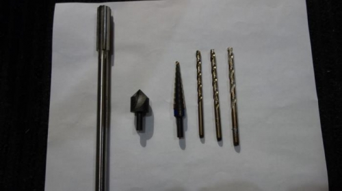

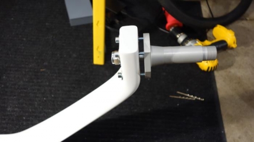

Brief Description:  Drilled and bolted axles to the landing gear

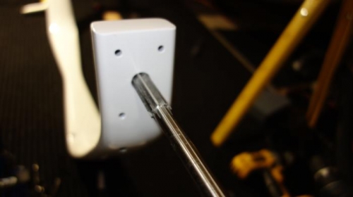

Used a reamer for the 15mm axle hole. This worked great, perfect fitting axle. I used a step drill to drill each side of the wheel pant mounting bolts, then used a regular drill to drill the center. Because pilot holes were already drilled, the regular drill bits would catch and wander. Using the step drill on each side of the landing gear leg prevented this and worked well.
