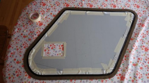

Painted edges of lexan windows
Peeled back protective film around edges, used masking tape to hold back. Applied electrical tape to follow mark I made on the front side of the window. Sanded edge with 1000 grit sand paper. Sprayed two coats of flat black paint.
