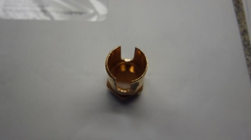

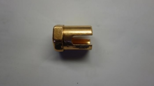

Brief Description:  Made tool for adjusting airbrake torque
Ran to the store to find something to attach torque wrench to airbrake control. Found a copper 1/2" pipe thread to 3/4" copper pipe adapter. This fit perfect. drilled an 8mm hole in the middle then used a hacksaw to cut a slot. Filed the slot until it fit on the airbrake control.
