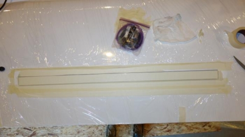

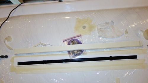

Date:  1-19-2016
Number of Hours:  7.50
Brief Description:  Fit airbrake cover on left wing
