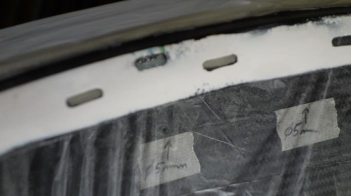

Brief Description:  Cut holes for windshield support bars
Difficult to guess height and location of bars. The Sinus/Virus build manual talks about how to install windshield with single support bar. Had to find pictures on the internet of the location of the bar (rivet on either side of center rivet of lower windshield). Had to place windshield in position by hand (two man job) and mark rivet holes, then cut slot for bars. 1st slot was a little low so it ended up a little larger than I like after I filed the slot to line up underneath the window channel. 2nd slot was right on. Now I have to mix some epoxy and fill in the bottom of the 1st slot.
