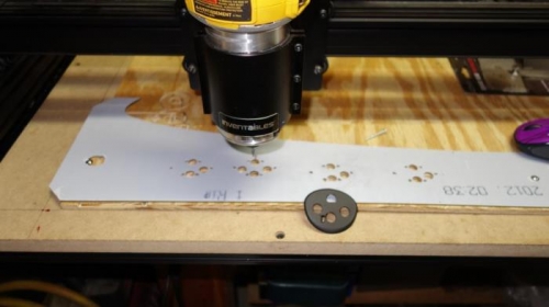

Brief Description:  3D routed Ray Allen control stick
Purchased the "blank" Ray Allen G401 control sticks with the blank face. The Sticks come with an empty circuit board so you can add your own switches (bought the identical switches at Digi-Key). Measured the location of push buttons on control board, entered the dimensions in my cut2d program and then used my 3d router to cut circular holes in the control stick face plate for my custom button configuration (still have .dxf file if anyone wants to do the same).
