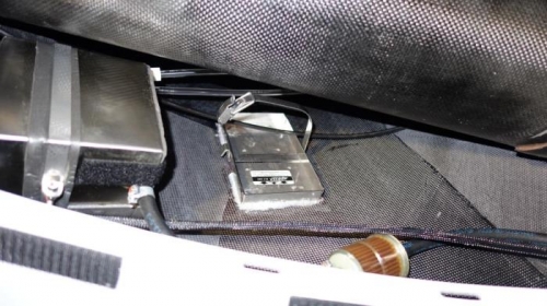

Date:  8-12-2019
Brief Description:  Epoxied ELT transmitter tray to inside of fuselage
Cut carbon fibre strips to fit ELT tray, then mixed up epoxy. Used shredded cotton to thicken epoxy and appled to the back of the ELT tray, then attached tray to side of fuselage and used masking tape to hold it on (masking tape works well because the epoxy does not stick to the sticky side of the tape). cut a paper soda straw into 1/2" lengths and then attached them to the inside of the fuselage at various spots to use as attachement points for zip ties for holding the fuel lines, antenna cables and wires.
