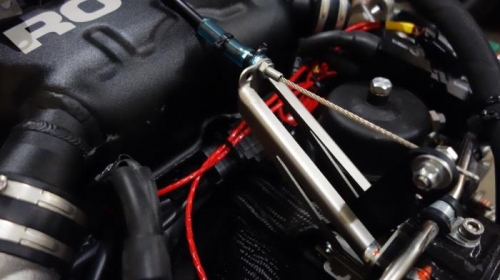

Brief Description:  Installed propeller pitch cable
Routed cable housing through left hole in fuselage (this provide the straightest route). Used zip ties to fasten down and fasten to rubber tubing at the end of the pitch knob. Threaded cable though cable housing. Tightened cable into pitch knob with 10 mm screw using loctite to make sure it doesn’t come lose. Made sure knob as turned all the way in and pulled cable trough cable fastener on propeller pitch lever. Installed pitch lever using loctite on screw fastening it to the engine making sure propeller pitch push rod was pushed all the way into propeller, fastened pitch rod to pitch lever (again using loctite). Pulled pitch cable tight and holding pitch lever with pressure against pitch rod, tightened cable faster using loctite. Tested by screwing pitch knob clockwise and watching it increase the pitch in the prop.
