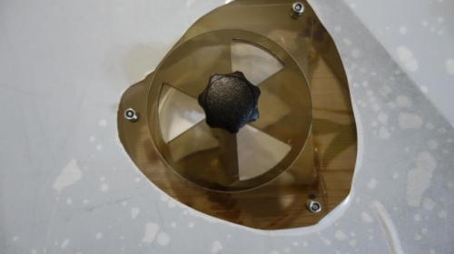

Brief Description:  Installed lexan window opening covers
Peeled back protective film off of areas were the windows slide open and fasten. Used a drill to ream the holes so the screws lined up with the holes in the window tracks without binding. Applied silicon to the tracks and installed camera windows. The window springs were sent attached to the wrong side. I had to disassemble them, flip them to the other side, then re-assemble before inserting window into track.
