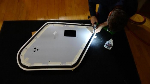

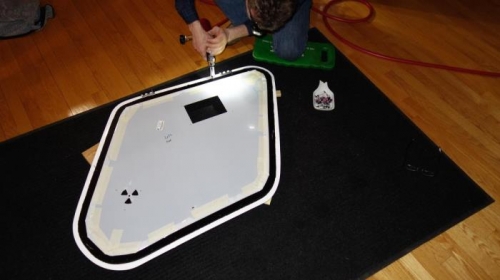

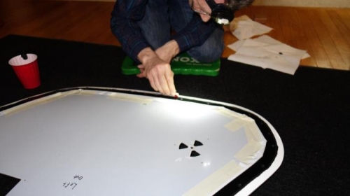

Brief Description:  Installed lexan windows on doors
Applied ~3/8 inch bead of black silicone rubber around the outside edge of window recess. Put rivet in 4 corners of window, then had someone help me drop the window in place guiding the rivets into holes to keep aligned. Using a rivet gun (Much easier to hold rivets aligned while riveting and and then keeping from jumping and scratching the window when rivet "pops") install all the rivets working evenly around each side of the window as specified in the instructions.
