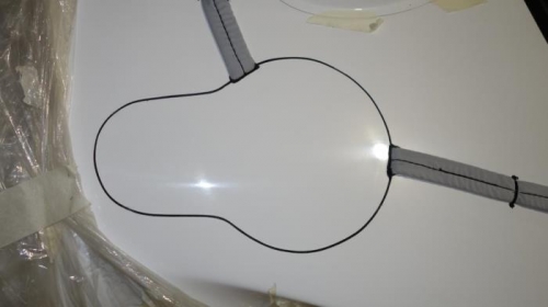

Brief Description:  Installed parachute cover
Used hot glue gun and attached parachute cover by gluing in 4 spots about 1/2-3/4 inch long. You don't want the cover attached too tight. Used black silicon rubber and filled in the crack so cover won't leak water, then cut out sticker that covers the crack so the backing of rhe sticker only overlaps the sicker by about 1/8 inch. Used masking tape to tape down the sticker centered over the crack, left one strip of tape in the front side of the sticker still holding it in position, pulled back the back edge of the sticker (leaving the tape holding it in place), folded it back, then pressed the sticker down and finished pulling off the backing as I pressed the sticker down. Then removed the top "backing" from the sticker. Used a similar process to put the cover sticker on the rocket exhaust
