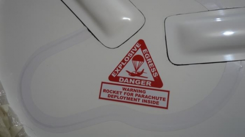

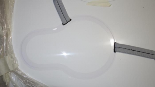

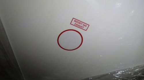

Brief Description:  Attached stickers to parachute cover and exhaust
Leaving paper on both sides of sticker, positioned sticker perfectly over gap around parachute cover, then taped down one edge. Flipped the paper over using the tape as a hinge and remove the backing from the sticker. Then flipped it back holding the opposite side just off the fuselage and squeeging out the air as I worked my way around both sides of the sticker with my finger. Throughly rubbed the sticker to make sure it was stuck down, then removed the paper from the top side of the sticker (This side is not as sticky as the other side of the sticker and is easy to remove). Used this same process for the exhaust sticker as well as all the warning stickers.
