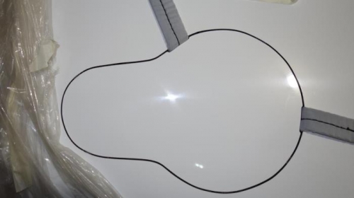

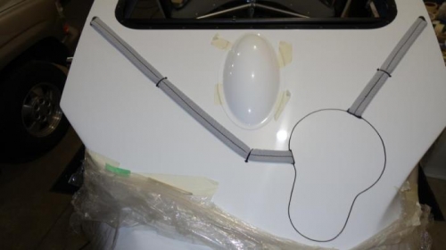

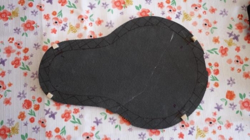

Brief Description:  Fit and glued in parachute cover
Used pieces of popsicle sticks epoxied to the bottom edges of the cover to work as spacers to hold cover flush with top of fuselage and keep an even gap around the cover. Sanded down popsicle sticks until top of cover was flush with top of fuselage. Use about a 1” bead of hot glue to in 4 evenly spaced positions around the cover to fill the gap and glue the cover down. Filled in the remaining gap with silicone rubber.
