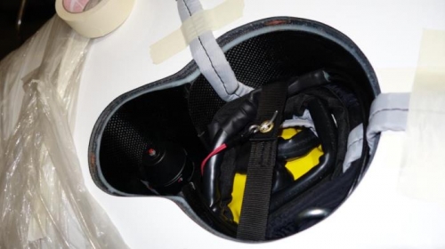

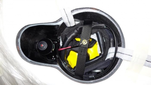

Date:  2-17-2018
Number of Hours:  3.00
Brief Description:  Attached parachute to retaining straps and rocket
Slip heat shrink tubing over rocket cable, attach rocket parachute cable to shorter parachute strap using smaller threaded chain link. Using loctite, tighten nut on chain link, slip heat shrink tubing down and shrink heat shrink tubing on threaded link. Attached fuselage parachute straps to parachute straps using supplied large threaded chain link. Coil straps in top of tube and attach parachute hold down strap by pushing loop through slot in opposite side strap and inserted release pin into hold down strap loop.
