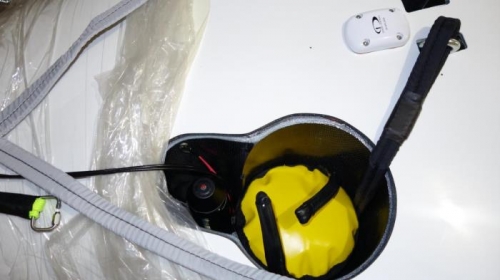

Date:  2-10-2018
Number of Hours:  1.00
Brief Description:  Installed parachute and fuselage straps
Installed parachute in parachute tube, coiled chute straps and rocket chute cable on top. Wrapped fuselage parachute straps around rear wing support rods in fuselage slipping one end through the loop in the other end, ran fuselage straps through holes ground in top of fuselage. Taped fuselage parachute straps to top off fuselage in correct location so fuselage strap covers fit.
