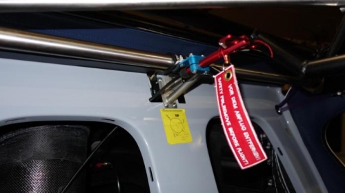

Brief Description:  Installed parachute release handle
Ground ΒΌ inch slot starting at bottom of hole for right aileron control horn at a 45 degree angle so cable move further away from aileron control linkages as it tries to move up.. Ran parachute release cable through newly ground slot. Attached parachute launch handle to metal wing support tubing.
