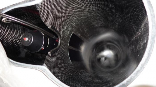

Brief Description:  Re-installed rocket
Remove rocket, removed plastic cap on rocket exhaust. Routed rocket launch handle out through the bottom of rocket tube and rocket parachute cable out the top. Loctited screws and installed rocket with screws through parachute tube. Put a piece of gorilla duct tape over screw holes in parachute tube.
