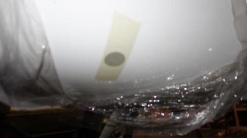

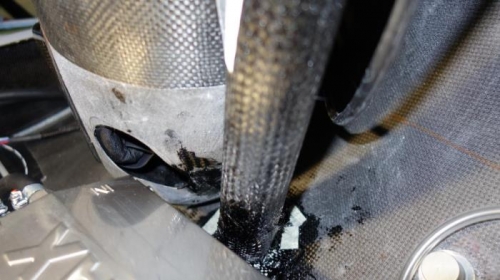

Brief Description:  Attached exhaust tube to fuselage
Cut some 1” x 6” inch strips of carbon fiber cloth (purchased a Aircraftspruce). Mix up a batch of epoxy. Used masking tape to tape inside of tube to the outside of fuselage (found the masking tape will easily release the hardened epoxy when it dries on the sticky side of the tape). This will hold any excess epoxy from running down the outside of the fuselage. Apply some epoxy to bottom of tube and fuselage. Applied strips of cloth in a crosshatch pattern adding epoxy as cloth absorbed it. Made sure that all points at the base of tube were covered with at lease 1 layer of cloth.
