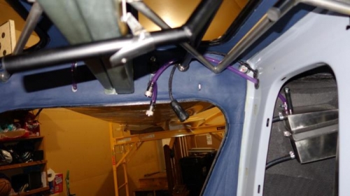

Date:  12-29-2017
Brief Description:  Installed right wing to aux tank fuel lines
Now that hole is drilled on right side, installed fuel lines from the fuselage tanks to the top wing female vent connector. Purchased a 2nd fuel line connector for the lower fuel line. Attached this to the fuselage fuel line mount (This holds the fuel line down so you always get fuel flow in this gravity feed system). Attached fuel line from tank to male connector and attached female connector to wing fuel line from bottom fuel outlet. Again used plastic ties locked with super glue to hold fuel lines on connectors.
