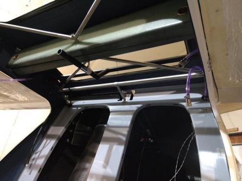

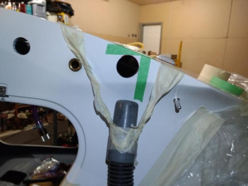

Brief Description:  Fit aileron clutches into fuselage holes

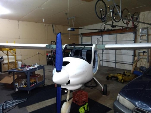

Slipped aileron clutches on ailerons, then installed wings pushing them on to the fuselage pins until the clutches hit the fuselage sides. Holes were a little small and not lined up perfectly. Using a transparency marker (water soluble ink) and masking tape, I marked the clutches on the fuselage and then I used sanding drum on my Dremel to sand the holes out to the mark. Had to re-fit the wings and sand the holes a couple of times to get the clutches/ailerons to turn without rubbing in the clutch holes.
