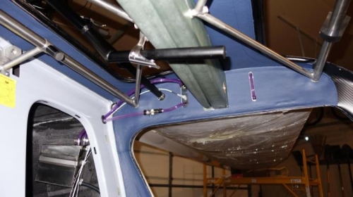

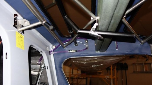

Brief Description:  Installed left fuel lines from wing to aux tank
Installed fuel lines from the fuselage tanks to the top wing femaie vent connector. Purchased a 2nd fuel line connector for the lower fuel line. Attached this to the fuselage fuel line mount (This holds the fuel line down so you always get fuel flow in this gravity feed system). Attached fuel line from tank to male connector and attached female connector to wing fuel line from bottom fuel outlet. Again used plastic ties locked with super glue to hold fuel lines on connectors.
