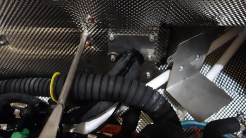

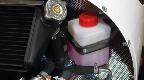

Brief Description:  Installed radiator overflow tank
Moved Radiator overflow tank to oil filler (left) side of firewall so coolant level could be observed when checking oil. This was a tight fit and just barely fit behind the oil tank lines. I had to re-drill the tank bracket so it would be level on opposite side of the engine mount.
