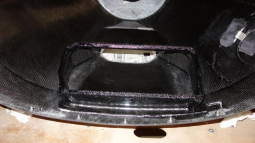

Brief Description:  Installed foam on radiator inlet
Primed the cowl with tape primer and attached the foam extending it ~1/4-3/8” beyond the edge of the baffle on the cowl so it would seal with on the radiator and baffle I manufactured. Now it is a nice tight fit so now all the air should go through the radiator. Also coated all exposed foam surfaces with a thin coating of silicon rubber.
