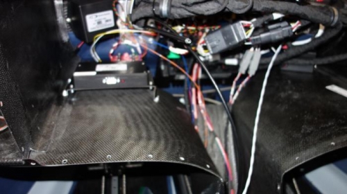

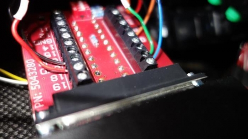

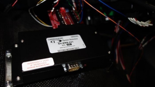

Brief Description:  Connected sensor wires to DB32 connector on EMS 22
Pipistrel provides a screw terminal to DB32 connector used to connect sensor and other inputs to the Dynon EMS-221 Engine Monitoring Module. I used my shrink tubing labeler and labeled the wires from the Fuel Sensor, Engine CAN bus, Ammeter, Voltage sensor, Trim position Sensor. I stripped and tinned the wires, connected them according to the schematic to the correct screw posts. I then drilled mounting holes in the instrument panel base, Inserted and compressed the blind nuts in the EMS mounting holes. I then Loctited and install the screws to fasten the EMS to the instrument panel base
