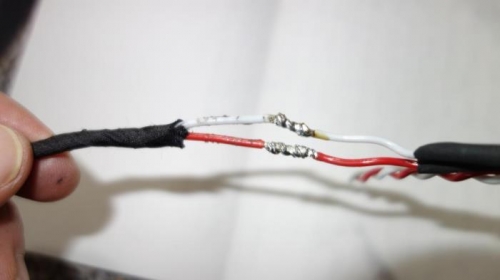

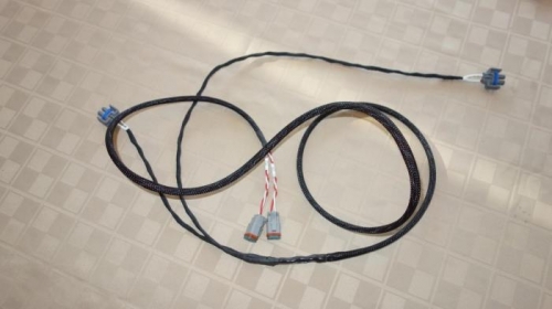

Date:  5-6-2017
Number of Hours:  3.00
Brief Description:  Install fuel pump wiring
Made fuel pump wire harness to extend Rotax fuel pump wiring and connected the Rotax engine wiring to the fuel pump. I labeled each of the two Rotax wire harness wires (Main Pump, Aux Pump) and then cut off Rotax supplied fuel pump connectors close to the Rotax fuse box. I shortened the Pipistrel supplied wiring extension harness to remove excess wire between the Rotax fuse box and the fuel pump cutting off a set of connectors in the process. I then soldered the Pipistrel wire harness wires to the Rotax wire harness and connectors that I previously cut off (so the could be extended to the fuel pump in the baggage compartment). I crimped the Pipistrel supplied connecters to the engine side of the wire Rotax wire harness and inserted it into the plastic connector shells, then connected the Pipistrel supplied harness with connectors already attached to the newly crimped connectors. Then removed the fuel pump cover and connected each the Rotax connectors to the proper fuel pump.
