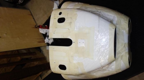

Brief Description:  Measured and cut out exhaust pipe holes
