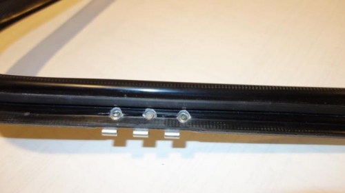

Riveted left door hinges
Ground out door frame behind hinges and then pulled on the rivets until the hinges pulled tight and then stopped before they pulled through. Because the rivet nail did not break off, I pounded them out the back
