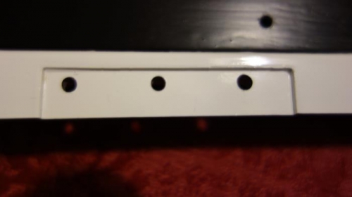

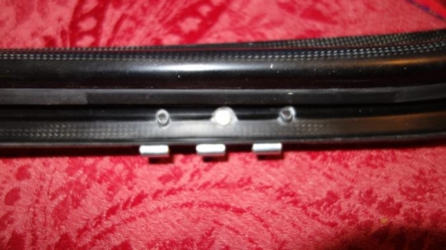

Brief Description:  Drilled out rivet in right door where rivet pulled
removed rivet and ground out back of door rivet to prepare for solid rivet install (decided to use solid rivet because it will expand as hammered to fill the slightly larger rivet hole caused by a dull drill into a hole that is at the edge of the rivet channel cover that pushed the drill sideways. see pic)
