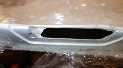

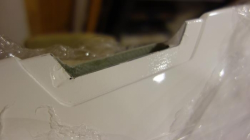

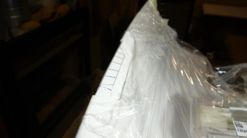

Brief Description:  Cut out wing tips to attach wing tip strobe lights
Cut out location for strobe light using dremel. Ground out area to mount light. Sanded lens to fit in strobe light opening. Attemped to pull strobe light wire tube but it appears to be looped back into the wing rib and end is epoxied in place during manufacture of the wing. I can not pull it out (used a long specialty needle nose pilers to grab tubing and it still would not come. It is really stuck). I will have to cut the tubing by making a specal tool with a hook blade on the end. Off to the hardware store.
