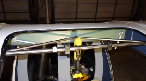

Number of Hours:  1.00
Brief Description:  Drilled center hole in wing spar
Used a right angle drill and drilled through the hole in the tubing from each side trying to keep the drill as straight as possible trying to get the holes to meet in the middle. It was only off by 1/8 inch. Reamed the center of the hole until the bolt slid in and out easily
