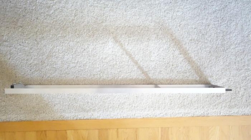

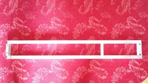

Brief Description:  Rudder Jig
Built rudder jig to hold top rudder hinge pin mount in correct location so it can be epoxy can fill in behind it to keep rudder aligned. Cut aluminum, drilled and riveted it together. Test mounted rudder and marked correct location of the rudder hinge pin to check accuracy of jig.
